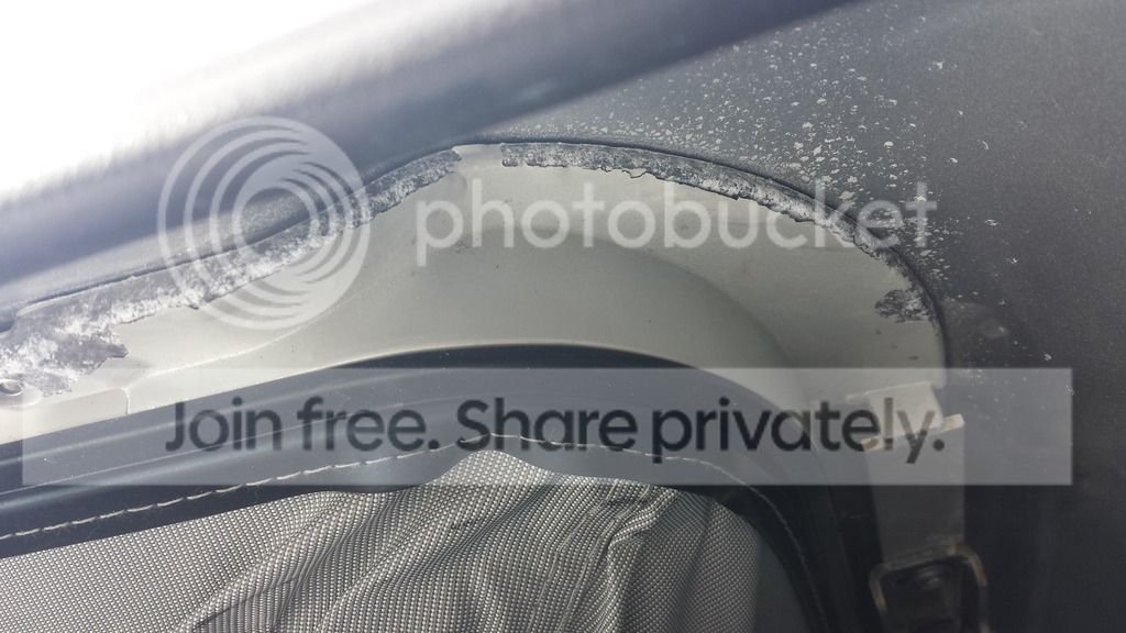

Realise warranty invalidated if I do anything to the seal but no confidence in VW repairs from what I've read on the forum and don't want to wait for it to get worse.
1 Does anyone know how much a new roof seal is?
2 Has anyone removed the seal completely and put the roof down fully with a bit of packing temporarily as a spacer to allow paint on the roof edge to dry fully ?

@Trebor , the roof sits on rubbers inside the mechanism (take a look when you roof is up)so removing the roofseal and close the roof should work .
But honestly , can't see the point of doing this every time you use the Cali in the rain...

Not suggesting every time just to allow things to dry fully in dehumidified sealed garage prior to gluing dry , clean, seal back onto roof edge with Sikaflex or something similar that will stick to paint / aluminium /
rubber . This should stop water getting inside the roof seal which seems to be the main problem .

All these theories about the rubber seal and paint drying times don't explain this loss of paint on the under side of the roof on our old 2014 SE
Thanks for that, not good at all, time to get my rubber seal off I think.
Seal taken off today, bad case of blisters mainly along edges rather than front of roof, bugger, here we go. My Cali was bought new in March 2014. No sign of any issues out with the seal, I suspect those who think they do not have an issue with this are those who have not looked under the seal.
Unfortunately it would seem VW do not have an effective permanent remedy.
